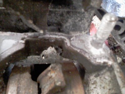

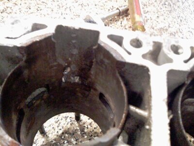

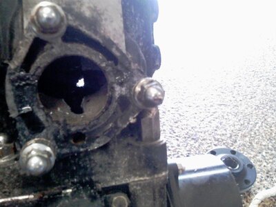

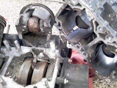

My god chap.
from the looks of it the chainsaw made your cylinder pretty much junk.
The cases are usable and repairable, possibly.
But damn, two days? That thing needs a bath.
