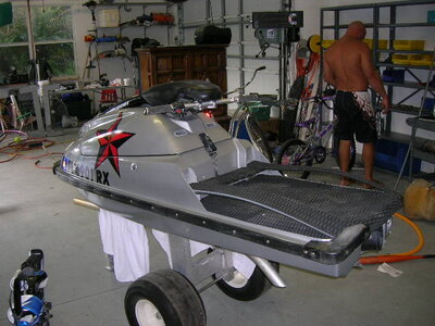

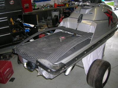

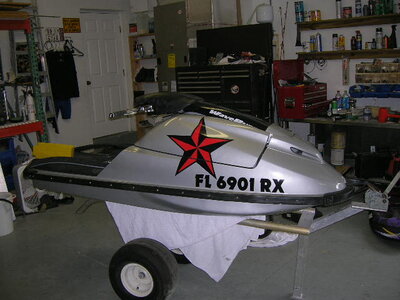

Who's got/ridden a flatdeck ski?
here's roberts ski. i dont think he has ridden it yet to give an opinion.

I know mine is nose light,so much so that I am looking for a top mount steering setup to go on my x2 steering system.
hhh
well i love it!! i was hesitant at first, but im really glad i did it now. it is different, you do loose the leverage you can put on the sides with the ankle/calf. But you make up for it in width leverage, so you just have to ride it a little bit to feel it out, nothing you dont have to do with any other ski the first time you ride it. my nose doesn't seem to ride high, no higher then i want it to at least. but i also have a -10 steering and pole setup, that no one likes but me ;)
and mounting is even easier once you get used to it. side, back whatever you want to do is easiet then with gunwales. i cant think of a down side really, i would chop a new RN up tm if i had one lol
