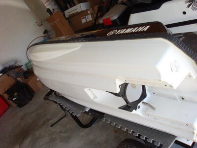

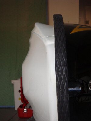

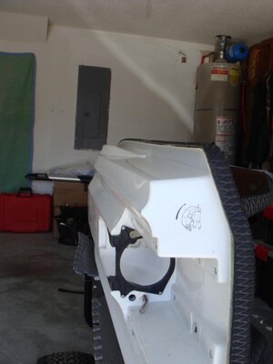

Your surf must be very different than what I am used to. My stock ski was fine in Daytona. However, my stock SJ in Tampa was a complete turd. I think the biggest problem is the length of the pole. The 650sx pole is about 4" shorter than the SJ pole.
There are tons of suggestions for the SJ, buy a pipe, buy an intake, buy this, buy that. My top recommendation for the stock SJ in the surf is shorten the pole. I wasn't sure it was the right thing to do. I hate taking a drill/saw to my ski, but after setting my 650sx next to it and seeing how much shorter the sx pole is, I was sold. Made a huge difference. Free, done in a day. remove from bracket, shorten to length, glue and rivet back. Done.
I agree the pole feels quite long and when its very choppy it's easy to get stuck hanging off the back trying to plane out or recover. i try to ride as parallel to the waves as I can carving them and set up in spaces to jump. They are very close together here.
Pole length from one ski to another has no bearing. Aka. 650sx to SJ. look how far back the pole mounts on a 650sx. That is why the SX is not as nimble as a SJ. Leverage point is farther back.
