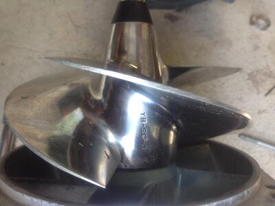

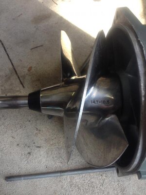

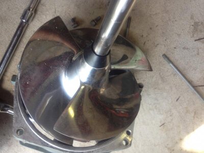

i took off a 14/18 solas straight blade prop and put on an 08 super jet stock prop and it made quite a difference.

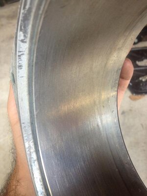

is your prop bent? is your wear ring in good condition?
On my modded ski I went from a 14.5/18 solas to a 9/15 hooker didnt lose any topspeed and gained lots of low end.

I would check your prop man. Even with what everyone says about the old race parts and port timing, if what your saying the boat has is accurate you should smoke the stocker. You have a ported 760 with a nasty pipe and big carbs?! That thing should be doing 52-54mph
We have a SN with a 61x 701 with only a redpipe and a blaster prop doing 50 mph... Not even a high compression head b/c we want to run 87 fuel. Your boats got tuning issues. Look at the prop, water routing is big too.
Figure out the deal with your prop before anything. Probably a pain in the ass to get them both off and switched but maybe see if your buddy will swap for a ride? Ain't getting no where if your prop is just straining the engine out.

Well I took apart my pump. The prop looked good, it's a solas 14.7-18.5. I dont know if that a good prop or not. Here are some picsIMG_1046.jpgIMG_1047.jpgIMG_1048.jpgIMG_1050.jpg
