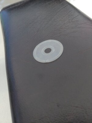

IMG_6246.jpg IMG_6246.jpg Here is another issue I have noted repeatedly: the fuel pump checkvalves develop 3 or 4 "pleats" at the sealing surface. Just a thought, if more corn was used to feed cattle instead of making ethanol, maybe "steak" would be less than $10 per pound.

View attachment 275566 View attachment 275566 Here is another issue I have noted repeatedly: the fuel pump checkvalves develop 3 or 4 "pleats" at the sealing surface. Just a thought, if more corn was used to feed cattle instead of making ethanol, maybe "steak" would be less than $10 per pound.
Creases in the check valves happen b/c of too much fuel pressure. Ever since I drilled out the tiny return hole and run a jet in the return line I haven’t found a bent check valve so far. (knock on wood)
