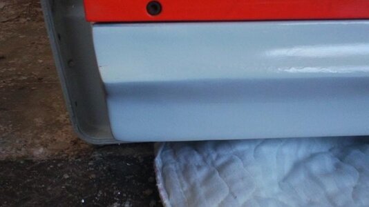

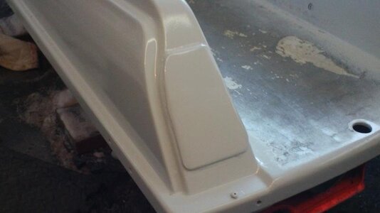

I finished the DuPont bed armor last night, the big chunks rub off when its dry and leaves a decently smooth finish but I wouldnt buy this crap again. I would spring for Line-x or stick to paint and dodge the rocks lol.

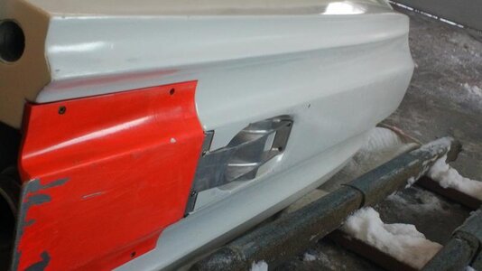

I dont know how much it matters but I couldnt bring myself to put the textured paint in the pump inlet so after I filled in the pump shoe seams I just rattle canned it, looks pretty good.
Just a fyi on the weight, I weighed it last night and with a quart of bed liner on it I only added about 1lb, maybe 1.5lbs. I have the hood down to 10lbs now but still have to reinforce it and add the breather tubes.
You filled the pump shoe with epoxy? I have heard of doing this but I dont get it I guess? Why and how? haha
Yes, I filled it with epoxy. I cost about 20 bucks for a large tube of west system epoxy compared to 50 bucks for R&D pump stuffers. The point is to remove the air pocket that will cause cavitation in the pump.

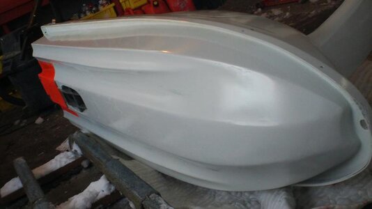

you used a very textured paint on the bottom of the hull? wont that create drag?
It will cause some drag but shouldnt be that noticeable with freestyle type riding. My main goal was to put a protective coating that will stand up to the abuse of riding in shallow water and beaching on rocks at times. not to mention it only cost $40 unlike my $500 paint job I had done last season that looked like crap quickly.

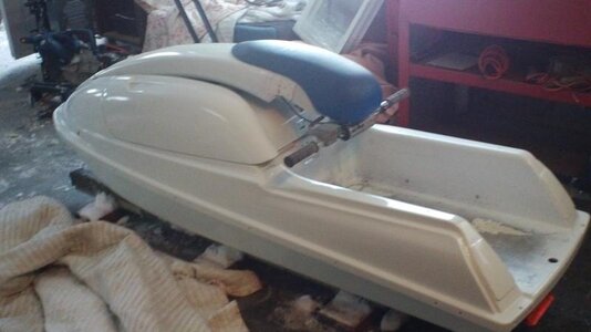

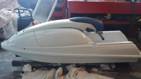

finished up the hull with a little bling, Its starting to come together again.
That looks awesome ! Where did you pick up the cap ?
Whats the trick to removing the stock cap? With the screws out mine seems stuck ?? Is it silicon'd in in ?
That is the stock cap, I had drilled and tapped about 9 holes in it from different exhaust nozzles I had on it before. I just used epoxy to fill them and a build up primer to smooth it out and rattle canned it. I found some pearl green that matches awesome from a hobby shop.
The cap should just pull out after the screws are out, its sealed to the hull and to the exhaust pipe. If you pull it out make sure you use sealer between the cap and seal, the seal and the hull and the flanged area of the cap where it slips over the exhaust pipe.
Yes but the cool thing is that you can charge people to sand their docks at the lake. It would like a 7 foot long belt sander.
Seriously though, I was like wtf?:eek5: That visible texture made me LOL.
Ive ridden a SXR with this type of coating and could not feel any change in the ride. It might shave 1 or 2 mph off the top end but who cares.
Took a idea from another riders build thread and used bilgekoat on the inside, looks good but man that stuff stinks lol
Also finished gutting the hood, its less than 10 lbs now. Started glassing it back up for strength last night...
