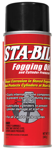

dump some oil down the plug holes, turn the motor over by hand a few times, this way everything has a nice coat of oil on them.
That would be my reco as well. Drip some oil or spray some fogger in there, and turn. Disconnect, store with towels or plugs in all of the inlet/outlets to prevent bugs, critters, and random metal floating around your shop from making a home of it.
If your bringing it in the house the exhaust has to be off so water shouldnt be much of an issue I would still get some oil in it before I dissembled it.
Definitely Fog it. The key to maintaining is fogging your engine. I fog after every ride just my opinion ! Another good tip is tilting the trailer and ski at the 1-2 O' Clocl position and blow out all the Excess water that lingers.
Definitely fog it.
Absolutely crucial imo. I don't ride surf, but water is water. Its not just the salt you have to worry about. We use Marvel Mystery oil in our kart engines, fogger in the skis.

Fog it is the best way to go. Fog through the carbs while still running until it dies then spray into cylinders and then turn over a few times.
