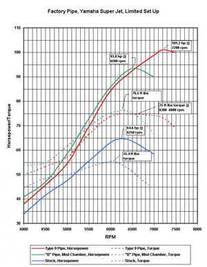

Type 9 makes more power, but needs more maintenance.
People like B-pipes for simplicity and low maintenance - not for power. (If they do, they haven't tried properly set up drypipes)
JMHO.
I have not personally tried a Type 9, but I have owned a Speedwerx Dry, and I have ridden skis with Type 4 and Riva Freeride Dry pipes.
They all have incredible pull in the mid-to top range.
When set up properly (water routing, ignition, compression, porting), they beat the B-pipe on the bottom end, too.
i've had a b-pipe for a few years now on a decent powered limited type 82cc, 190psi compression good ignition and carb set up and i'm pretty happy with it. i did buy a type 9 pipe last week that chuck at Xscream will be setting up soon. he said i will see a good differance with this pipe set up. the pipe is much larger and heavier i hope i can tell you a lot more in a few weeks.
I would like to know what you think.
I have a b pipe on my 08 superjet and an a fx1. But B pipes have not changed in years so i just think the newer pipes have to be way better just need to put on right.
The torque & horsepower curve is stronger on the b-pipe up to about 6500 rpm which makes them popular for freestyle/freeride setups.
How much of your riding is done above 6500 rpm?
