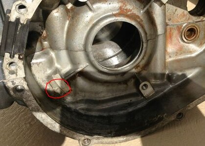

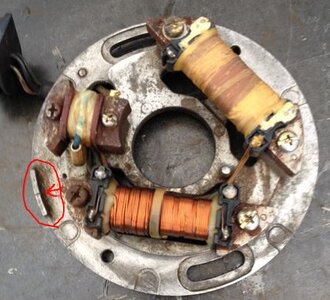

is there a thread somewhere on checking timing? No idea how to do that, but how far off can it really be? The stock 62t stator only has so much play.
retroicon
XX-xx-XX-xx-XX
That's what I did, lined up the marks. It's stock timing. That's kind of what I meant by "how far off could it really be", they make timing pretty easy to setup and you can't put the stator in backwards or the wiring harness wouldn't be able to feed its way out.
