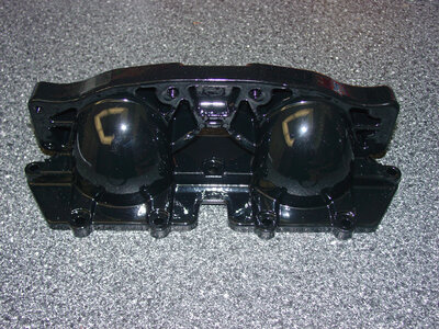

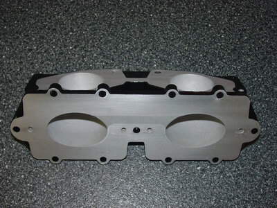

Devcon Aluminum Putty is what I used to fill my 760 intake manifold. Then I used 120 grit sand paper on a glass table to sand it down smooth and finished it with 600 grit wet sanding.

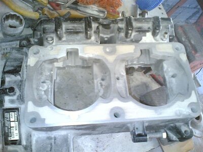

I would go with A+B putty - from Randy at watcon.com
It’s “mon-metallic”, so if it does flake off it doesn’t cause and damage and its cheaper the Devcon or J-B weld.
It can be smooted into position with water and your finger to reduce grinding time.. Many top engine builders use this product. I know of many pro cases on the line filled with this stuff. Also - it's used on race heads for cars also.
http://www.watcon.com/Catalog_Pages/AB_Putty.htm This is enough to do approx (3) sets of crankcases..
The cases, intake manifolds, etc must be beadblasted or scuffed with a grinding wheel for good adhesion.
