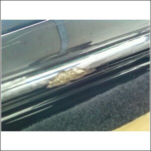

So, I dropped the ski in the other day off the ramp onto a rock. I went to check it out. (first pic)

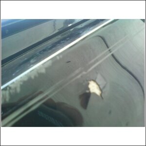

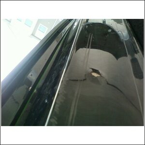

Then I look up and I see a piece of the hull that is protruding! (2nd & 3rd pic)
It is where the aft outboard battery bracket bolt is screwed in on the inside. It looks as though it was over torqued or something. WTF!!!
I ski is brand new, less than 20hrs.
I figure I can fix the the damage in the first pic cuz its and external chip (1st pic) but, what do I do about the other (2,3pics) There has got to be some loss of structural integrity since it is puncturing damn near out the hull.

Sorry about the crummy pics,...........I cant see the damage in the hull because the the bracket to the battery is there and the bolt is what is behind the damage.
It is actually pressing out, which is how it cracked the paint.

Yeah don't touch any thing and bring it back. Also tell them you want to be there when they remove the bolt. That way they dont try to BS you.

I installed my rear motor mounts with the rideplate bolts once. They are about a 1/4" longer than the ones that should be there. I was worried they would push through the hull like your suggesting.
It first glance I thought it was one of the motor mount bolts....that would make sense. It is clearly coming from the battery mounth though.

These retards forgot to put one of the washers on one of the battery bracket bolts. The goons have had my ski for damn near three weeks and have yet to get it fixed.

I would have a place fix it, or tell the dealer you want a new ski.
Marine Tex will be an OK fix, but a quality epoxy like West Systems, then followed by paint would be best.
