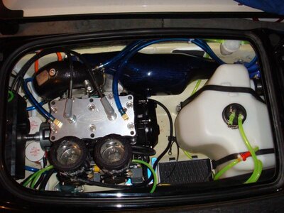

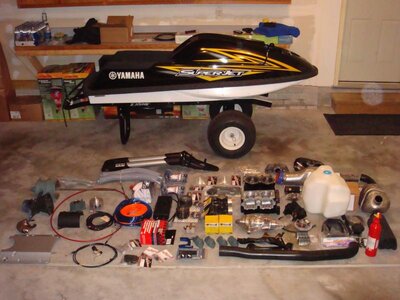

Here's pics from my Superjet build.

Nice job on your ski! Looks clean.
