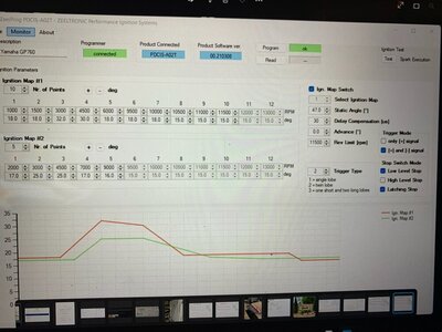

We had a similar issue, but with Yamaha 760 electronics, where the zeel was set to 3 lobe but we only had two, or vice versa, can’t remember. It’s worth checking, not sure if the kawi is similar.

Just installed my zeeltronics on my sxr 800 (actually it's a 920 dasa) and it has the wax programming in it, it starts right up but will not rev out and I have raised the rev limiter way up but it still only goes half throttle and boggs. Check it on a laptop and it seems to be doubling the rpms, any ideas I have adjusted everything on it and used both programs but no help I think I might have a bad unit..
how many lobe's do you have on your wheel?
