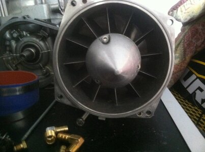

I have a TBM on my 155 so mine actually has a big hub like the magnum pump. But without the hub I can see the volume difference on oem vs mag. It is quite a bit. But I do think more veins will process the water faster and therefore help reduce drag which should result in less load which could result in a smaller exit diameter or, taller prop.
Don't know if it works exactly like that . i think the more veins the increase in pump pressure & load on the drivetrain ,needing a steeper root angle.
