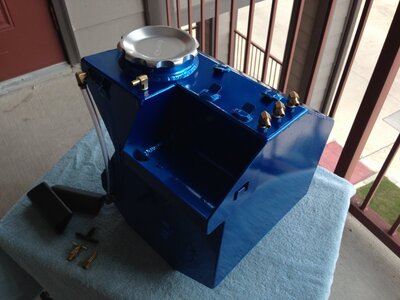

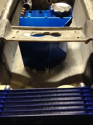

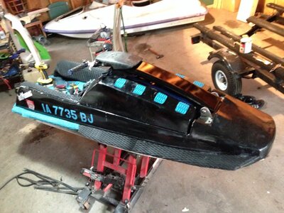

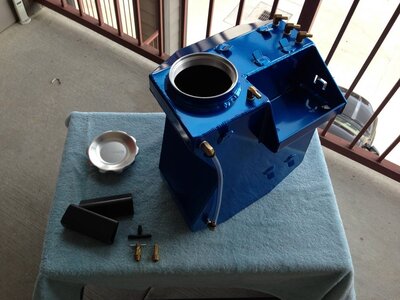

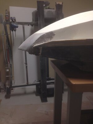

New tank, new oil cooler radiator, and I broke a new WDK Right hold... had to make a new hold off the original.

Planning on making the nose fit with the oil-cooler radiator so it is air cooled and then I am going to take an SLP 2:1 exhaust, chop it up, weld it back, and plug in a T3/T4 turbo to the backside... All fuel supplied using Microsquirt's EFI module, carbs are too old-school.

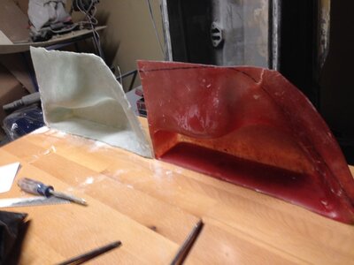

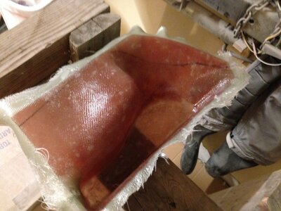

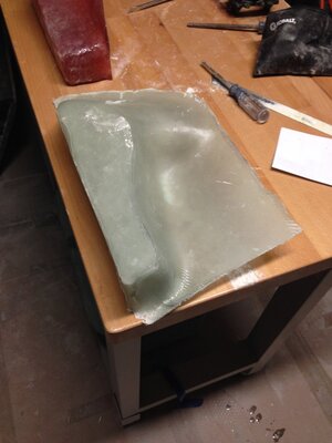

Crisco is the best mold release ever... 6 layers of 8 oz. produces a lighter and stronger product than the original. At least I have a complete (unbroken) set now.
