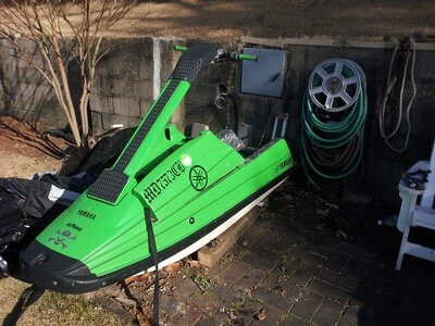

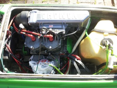

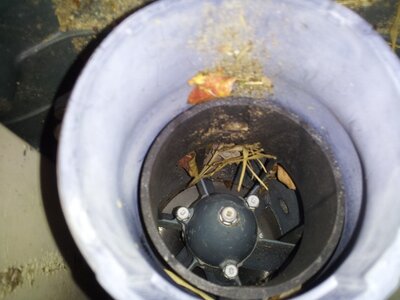

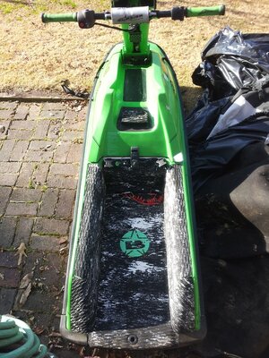

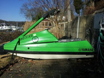

Hey this is my new ski i got a few months ago ski which i dont know exactly what has been done to it and wondering if any of you could help me out.
I believe it has a 93 701 engine, aftermarket pole, prop, intake grate, quick steer, handle bars, finger throttle, water box, hood, and a bilge pump.
Does this sound right and is there anything else that i missed that you can spot out in these pictures?
Plus it is soon to have watercraft factory footholds

knew the original owner of it, that's a after market pole and hood. and it has the 701. runs pretty good just has a crazy death wobble at high speeds! it may have some goodies done in the motor too, not sure if pat did anything to it or not
What is the average length of a stock superjet pole? I heard most poles are about 3 or 4 inches shorter than stock.

Any recommendations on the next mod i should do? I was thinking a new pipe, possibly a limited factory pipe.

Burton Im gonna look around for a good deal on a used pipe until summer. i found this thread and its very helpful. http://www.x-h2o.com/threads/34340-complete-list-of-pipes-for-the-superjet

I am about to put footholds and am wondering how far from the back i should make the cuts for watercraft factory holds. I know its mainly preference but i want the ski to be ride-able right when get home from school this summer. So where do you all think would be a good spot to put them?
Also i want to make a front foot hold and wanted to see how much you all like them and if it is worth making it.

You will never get a feel for it until you ride it so just pick a spot. I would suggest keeping them free of the exhaust pipe since it just makes a little more work. I had WDK holds in my RN and the fronts were JUST at the exhaust. As for the front foot hold, just snag the pancake pete hold or something similar, they are pretty cheap, probably cheaper than your time to build one.
I have a 650 B pipe, it's very similar to the 701 but the manifold has a little smaller port but it can be opened and the chamber is a little longer. The manifold is still attached to the engine and it's in storage. I'd be happy to sell it but I just have not had any time to take it apart. PM me if you're interested.
