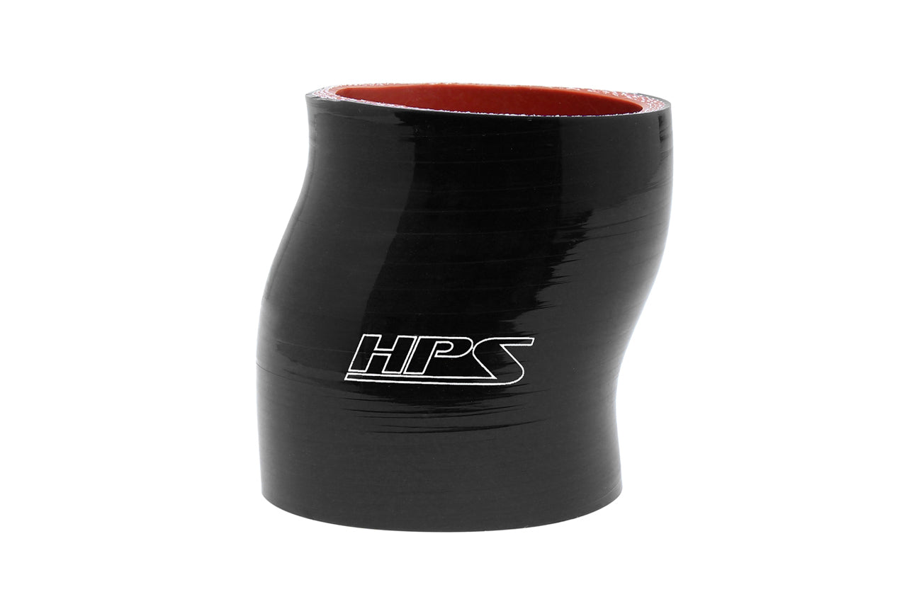

The engine mounting plates are the ones that came with the Krash. I am running couch mounts and they fit fine except I had to use an offset coupler on my exhaust to clear the motor mount.
@hornedogg79 this is the offset I used, 6" length.
