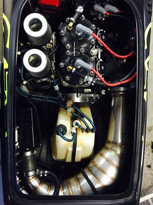

Now with a TNT pipe in it. Only an hr of ride time on it beacuse of the 40 Deg water temps but already very strong on the bottom and middle. Top is getting better. I think i can get the top dialed in with more work and jetting on the pipe. I have a few ideas as usual :) Very happy so far

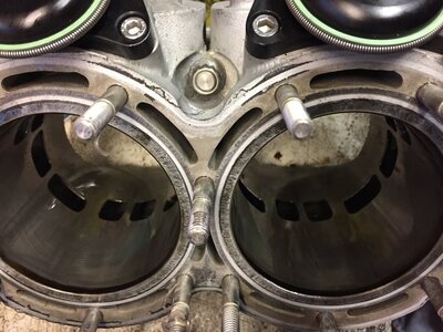

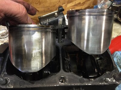

All torn down for complete rebuild to all even slightly used parts.
220 gals and look at this motor. Very pleased.
View attachment 298163 View attachment 298164
Looks very good! When you take the pistons off the wrist pins, have a look at the crown above the wrist pin.. You will probably have mild discolouration from what i can see. That will usually tell you how your motor is running.. I am really really impressed.... Subscribed!

Motor is always set up light on my set ups, never dialed for kill. I dont need it. Id rather run a 1500cc motor at 32 deg and 185 psi, then a 1000cc complete race fuel run it at 250 psi 36 deg timing. I like consistancy. Easy to see after all those hours by these photos it was super light.
For those who have ridden it, well over 50 people now, ask them how it runs. :) Its still all there. Could i get more, definitely. Dont like to wrench, I like to ride. I only wrench to ride. Plus you can tell by looking, who else would do a complete tear down and rebuild to new on a motor that looks like this? I'm looking to not have any wrenching to do for 2016 other than tuning and trying different Pumps, Motors, Exhausts, Ignitions, Carbs, Reeds, etc. I like to play and tune, but not affect my ride time.

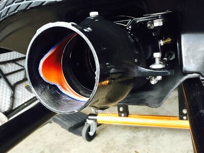

Well the fresh rebuild TPE 1105 with custom porting arrived and we have been testing manifolds and reed packages. Second times the charm.
Erik from TPE and Ed from Full Spectrum have been helping me dial this in. After wrenching and numerous water trials i think its finally there. It now hits harder than ever.
Possibly a few more trials in the future with manifolds and porting. Then onto pipe and pump trials. Going to try the new TNT V3. New experimental pumps,155 and 160s are on the way.
