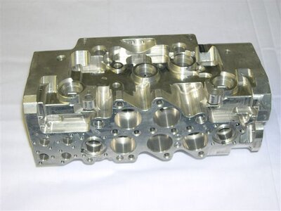

Here is a pic of the pnuematic compression fuel injection body.......with some extra holes for other goodies.
This is 7075 al. There will be a series of air/fuel/electrical lines connected to this unit. This piece was roughed and semi finished on an Okuma 3 axis. Final boring was done on a manual Atlantic jig bore
Fuel and air will mix at a fairly high pressure, which will enter the motor with a high velocity.
