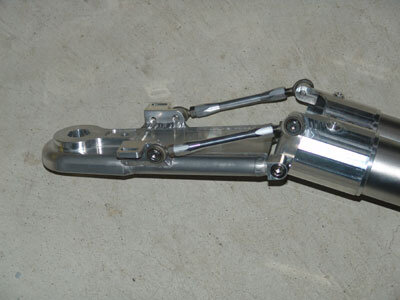

hey, what about this idea. Get an XMetal Pole from Pat, have him deliver it un powercoated and then wrap it with Carbon......... you get the smooth lines of the X Metal with the appearance of the XFT Carbon........
You don't want to wrap aluminum with carbon. Corrosion can be a big problem. Also the x metal pole weighs almost double what the XFT weighs.

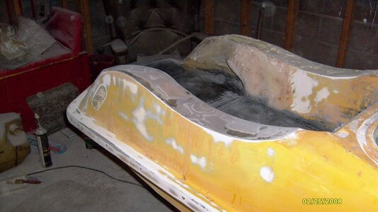

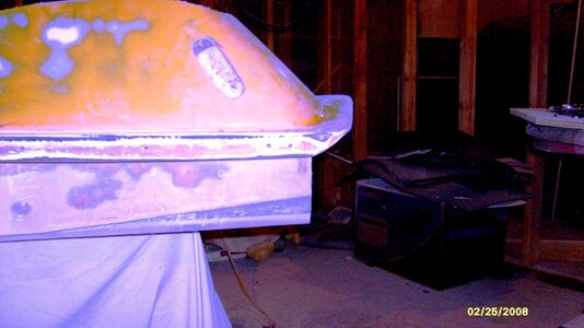

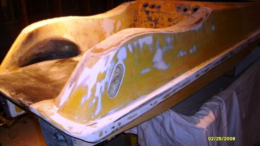

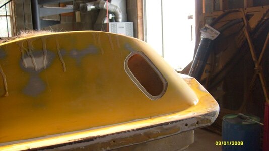

In ruff form but cut hand holds on both sides,tray comeing along, and started shortening the ski.Ya it was all done the back but thought about it more and more and decided it needed to be done,so i cut off everything i previously did. knocked off 1.5 in just before the plate nut.Drain no longer comeing out the rear,comeing out in the pump area.Now looking for a TBM pump cone and a 12/16 mag swirl cutback,and blue printing pump.

HELL YA..it will be finished 4 sure.im just pickey and want it to be just the way i invisioned...im so close to ordering a BUN pole,i like the xft but has to much straight 2 it?i like how the BUN moves up and down for steer adj.

got one hand hold the way i want,then u haveto grind around the hole,round the edges,and sand the inner side.by doing this u will be able to lay carbonfiber/glass level,so when u sand flat theres still meterial holding ur hand holds.for the inside make a sump around the whole thing so glass will hold the inner side 2,beef up good water in rolls will hitt hard in there.i used my fingers and ket grabbng in there like i would in a real situation,till disired shape,use brakeup glass first for mold then carbonfiber.PICS SOON
