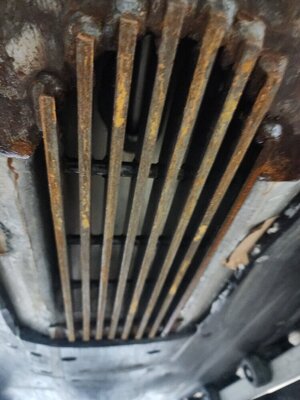

Had a new intake grate built with some gussets on the back side to reinforce the tines. So far so good, no broken tines and the pump loads the same as before.
