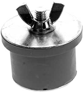

Can use Plumber's Plugs aka Expansion Plugs to block any Round Holes; two for the Intake Manifold and one for the Exhaust Manifold. Test thru the Pulse Line.

Can use Plumber's Plugs aka Expansion Plugs to block any Round Holes; two for the intake Manifold and one for the Exhaust Manifold. Test thru the Pulse Line.
That's a great idea. I'll pick a few up and test it out. Thank you!

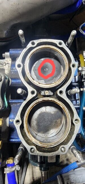

I thought so too, but it's just a clean spot from me dropping a socket extension through the plug hole to push the piston down while using an endoscope to look at the wash. Hindsight, I should have just turned the coupler.
