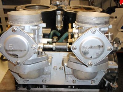

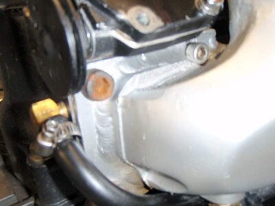

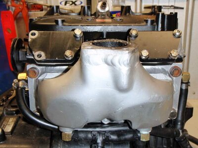

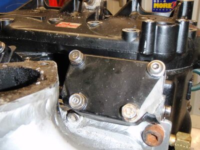

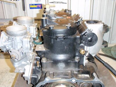

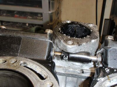

Here are Tofa's pics.

So it looks like you cut the mounting flange off of the manifold and welded a new one on? Those water fittngs on the side go into the cylinder because the jackets are welded up? Looks like it fits pretty well, is the top flange cut and rotated or what is that weld for?
I ground 5mm off the manifold to allow for the 5mm spacer then ground all the mounting holes off and welded around the outside...then got the porting tool and matched the inside ports to the 66e gasket..then welded up the holes where i had gone into the water jacket then match ported it. Only one of the water ports lined up so i used that plus the extra ones going to the side of the cylinder...it works fine and the coolings just rite[well just rite for this cowboy lol]...I had to weld a 16mm spacer to the top of the manifold to get the header to clear the powervalves[with a little grinding to the back one]..I havent had to cut or weld my header yet and will only do the if i can find some low profile gas valves.

Looks good. If that spacer was any larger (lets say an inch in total) Would the headpipe smack into the side of the hull?
Yes it would...even with me taking 5mm off the manifold to start with its still very close...Its not the header pipe that hits its about the first 100mm of the chamber that rubs
