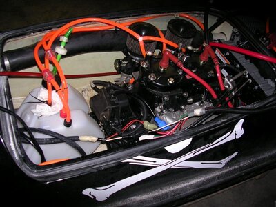

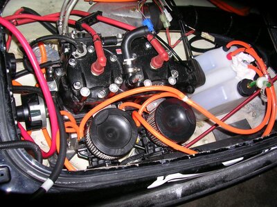

Finally got the motor shimmed and bolted in. The only thing left to do is put in some lord mounts for the pipe, plumb my cooling, make a bracket for the gas tank and mount the Ebox. I fired it up tonight and DAMN it sounds good...these motors sound nothing like any 62T/61X motor I have ever heard. Hope to tidy some things up this weekend and go for a test ride if the weather permits.
Here are a couple pics of my extremely dirty/dusty engine compartment...glamor pics coming in a week or so :arms:
