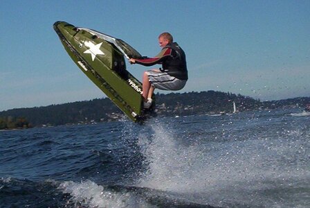

do like all silver/grey with lines to look like steel panels airbrushed circles for ribbits and the u.s. navy/ airforce sign with the star in the middle and the wing type thing on the side. thats what i wanted to do at one point
W
wydopen
i cant copy someone elses ski..lol
