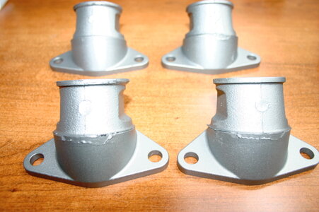

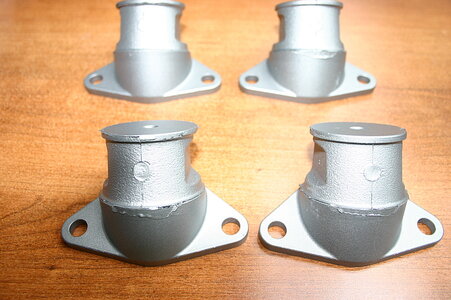

DC the battery, dc the choke cable, dc the throttle cable (learn how to remove zippies w/o breaking them, since I had no spares…we had limited tools, and had to stop to go get more at that point, for mine were discovered to be off-site with my other skis). I wasn’t strong enough to get the moto mounts off, and it made me SOoooo VERY MAD :rant: that I had to ask for his help…that part actually ended up being team work, like many of the other things to follow!! My Supervisor ended up having to break/chisel (whatever) something (I don’t know what) off of one of the old mounts for it being seized, while I was telling him he was doing it all wrong, lol

! I learned what you guys meant by ensuring the mounts were properly aligned.
This is where my question comes in…we did this with a small screwdriver tip:argue:!!!! First time was almost perfect, but not pristine perfect, so we did it again. All seems to be well, and it feels smooth and cool to the touch. I even stood in the tray to see if I could tell any difference. Possibly so/maybe not…it’s hard to tell out of the water, and maybe new mounts feel slightly different than the seriously old original 97 mounts. I really can’t notice any difference for sure. I hear (at that point :argue
there is a proper measuring tool.
Should I locate one of those and measure before an actual water test? Does everyone use this tool that is supposedly rather expensive for a one time job? I know I would feel better if it was measured properly, but maybe that is just me. What should I do please? Do every single last one of you use this high-priced measuring tool? I would simply think that is something which must be 100% precise without fail, even though it already looks/feels/seems correct!!!
