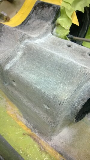

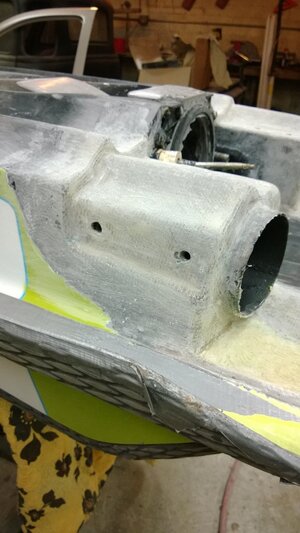

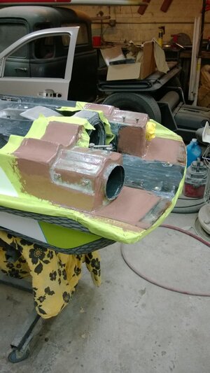

I got to work on the ski a bit tonight after work, did a lot of grinding and fitting of the ride plate, also picked up some clean bolts. its a bi$ch keeping the threads clean, and working around the bolts. Then mixed up some Epoxy thickened with 407, hope to prime it this weekend and then paint. I still need to layup another plate or two also. Probably doesn't look like much but this took like four hours!

Next time fill bolt holes with clay, this will keep your thread clean, then clean the clay out with a tap when your done. Lookin good btw.
Thanks for the tips, I was worried about losing the holes when I did the glass, but for the filler that would work good.
