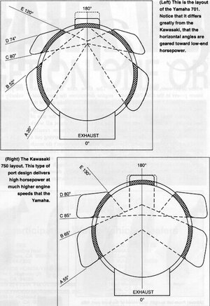

Yep the Yamaha transfer ports are aimed more toward the boost port opening and the roof angles are a bit steeper which gives the engine more bottom end power and fuel economy.
Porting the Kawi cylinders with similar angles will help, but they're more suited for racing then freestyle.
Keeping the roof angles steeper and the transfer ports aimed away from the exhaust port opening helps with keeping the air/fuel mixture in the cylinder at the lower rpm ranges.

What is the source of that information?
