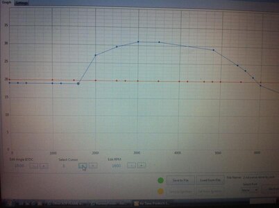

So the Flame doesn't retard the timing for easier starting like the MSD does?
With the Flame or Epic you make the curve... Like I have mine start around 19 deg & holds that until 1600 RPM.... I can make my curve start the timing at what ever, takes 2 minutes to make a curve & load it into the ATP system.....
In the PIC is my curve I'm running with my XS1000, this curve is insaine the hit it has!

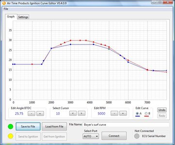

since we are sharing curves, here is my new surf/flatwater curve.
Curve A is for surf, Curve B is for flatwater.
OCD Solutions
Rentz, GA
I don't believe in throttling my motor. I want max power all the time.
LOL, i'd say you don't have enough power then, have you ever considered switching to an X-Scream powerplant? :biggrin: Sorry Matt, couldn't resist.
Nice curve Boyer! You really get a hard hit 31-32 and pull it back down.... Give it a quick try
Already have it loaded. :bigok:
