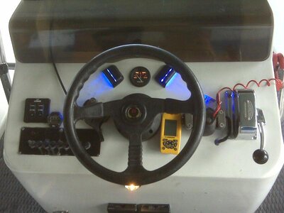

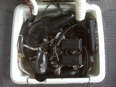

just finished up the console. i added a marine temp gauge (plumbed inline with the pisser), a couple of accent lights, a choke (stock throttle lever under the wheel) and a REAL throttle controller. :woot:
...and an engine shot too....

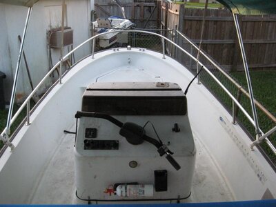

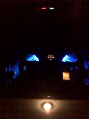

heres a stocker pic... and a night shot from my angle..... i need more LEDs!:Eyecrazy:

im wanting to illuminate the switch cluster and throttle / start/stop area on either side of the wheel. the tristart ball will mount right on the bezel under the wheel and point right at them. do you have 2 of the S0803-200R? if not, 2 of the S0803-2000?

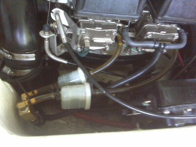

yesterday, i did a couple of things to the whaler....
i ditched the single 1/4" fuel line running from the tank a/b valve as well as the 1/4" TEE at the carbs and ran a 3/8" feed that splits off into 2 1/4" lines, to each filter then to each carb. i did this because it was starving for fuel at high RPMs after a minute or so.

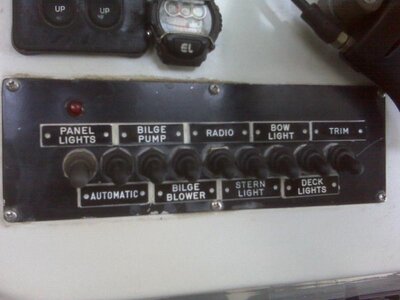

i also labeled my switch cluster..... the red LED above the "panel lights" switch is connected to my overheat sensor on the head. it will light up instead of killing my RPMs.
