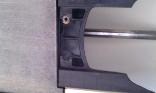

I just broke mine today. I hope you still have them available. Thank God I didn't lose my Worx intake grate.
