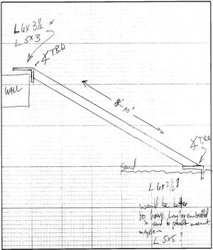

I think penguin is drawing something up.

I forgot steel is sold in 20' lengths, so the same size should be used at top and bottom.
quick sketch:
Nice.
I personally like the idea of a 10' ramp, just because it reduces the angle. The lesser the angle, the more likely one guy can pull up his ski on a beach cart by himself without having to find 1-2 guys to help.
Going down in the morning should be easier, too. I figure a guy could get at least his stand up down a 10' ramp by himself, maybe even a Blaster.
