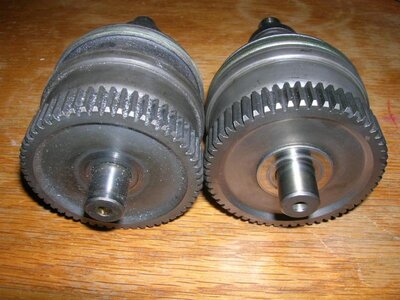

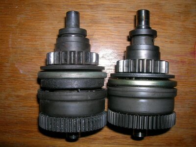

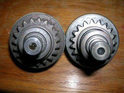

got the Bendix and seals a new spring, still gotta get bushings.
here are a few pics.
anybody know how to test the quality of the Bendix?
on the "new" bendix the front and back shaft measure out a little thicker than the one that blew, must mean it has less wear, the gear that engages the flywheel looks to have the same wear as the one that blew.
