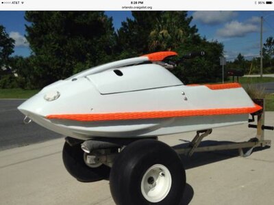

well, after testing fit on another RN SJ, and making a few test sets I am happy enough to call them good. I could have left them bolted on with some SS hardware and silicon like I had, but I went for the epoxy with some cabosil to stick them a bit better. I dont know if anyone else wants or has an interest in them, but the mold is good, but to install them you need to be comfortable with cutting your stock rails to fit these on.

I have been working on these for ahile and wanted to see what everyone thought. This is my 3rd set I have made so far and it was my first full scale run. I still have to redo the molds for them to get a better fit with less sanding, and test them on a few other skis besides my WCF hull, but they in theory should fit any stock SJ by cutting off the stock rails, and then install them just like a pair of foot holds, scuff up the stock hull, pre drill and bolt/rivet them on and use some epoxy resin to stick them to the hull, then turf. They are 2" on the top, and taper to 3 1/4 with a 40* angle on the rail.
