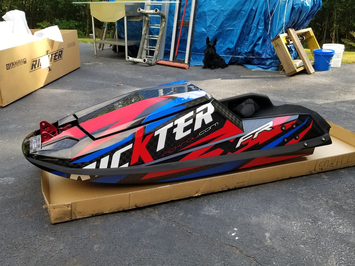

When I arrived home on Friday I had about an hour to myself before I had to leave to join the Girlfriend for dinner to meet her family.
When I cracked open the box the realness finally set in!
szVhbTHWcJb6QVbRo8SWbM4Q6cXSXKzR5Tl4cTBBd3YMQ2M5CQPe904ECJ0R4d_5qige7ppHfh3UpZcNoLQjBuxqrI-zNz-rPD-st-GadOIIASKocBLmkwfWf4VF_SrNWPYRxoICjse60YVU_YWYXWCF8CUaun1qjXCI8PfImIdnkNjIkVzWfB3StUleeDdbxJ6y1jvby6xcd2kIvo0kZi1RbzJIBKPyDVf1yZpblQDJShjB1emyGHx74V-evuSqKnGUNkIoN57VwkU43J_PGKo5nncLCUF3fIabLkCEarK3Y9nKnjowhZyEd0mo0IXCs4S_EZgvZGfRWIXkPlX0m7u2O0R2RDo20yaibySFAns2a1TuFwDdmTS3QxqkU-aVChxYLimTuDBgen1IuqXeWF7reiSQsbHmcWP886kVRBdBBslpx34m6nXrxN-bZidisurMFo95_qFKS5QCqOgjh5QYIhwTLhrhBZTyQDoJWVGGk2LhiGO2nkdGvo1v-wUzPC2JoI1jHW_sfrUqcpDnSHs9_Hp5ABYKLvooA_tDBQ_mgycYTYPgHMnehTnZ3spmd2unmvJ3MCeha_12fNy0elS0pSkN3nreeRnt38-hj4eFAyRNpnYYbS_5SIHrEPTSE12eGP7VKICQ0SSATmyh3YoEdFKc8t3MIni1MA1eRkwkCrfgXvdHRvcXaw=w661-h881-no
lYHlNsbAQaUeN20nFVanx18TiBqh8D7S6mzCA5raGHBnhiOfS_ZHlpK2zI_GB-N1MbUXYSGJZziF1oXK9A0s3cOIb9AAGFTrH6lOXCMgSIfq49WRqVBqo3AVwFdoXkdF55uv-r7bFbUVcQkDpeXhAODz2zfGDEHQh4l0HGzQ5vgfyvJAbj5YZotSq5AdnSZpsrQ1ToF778ClwkbsiIB9vCHOOvmlENAYnPwtP5MXKkPT_b7V19e_SvijXEDXqCUraTUliPUyguecNSEJQq1tpRXhtrk5REpZ9UDmN-ZGXsWVsakp5J_BP2gJP2c_ZiOM35xcwxpFEVq3Yh_WaFRWxlwiLJNC_-tzsl1nYSre2tqnKW7iOc3uPF0JFhxNJUYyHv0pkv7lXLLQYu1DHEcPdnBQCK8ZAdLweCnjgVye1sGJrDqS_-pVmFFuNLIlkz3f0EBjXg58vmgm8HYj9lFhLkZh4D6YMgggIPid7zn62Nag25vjrEbA1TTiTVi9dvkRwoVP8OVEUxX3fb0-ccU1hWJdtzCjZO-wgEgiizXvYruNgaba93IB12Dcb4LUkj7-rRUTJTH1Oc9qZ-xfkwnSAWROPgGhHMX6htK6XZT7UrT31a-2rdO4F8oxUHUFv-FgXloYEHXvH9hjvNVNb9_KtDsOpAWnsKcLPYU-F-O-L6WOCpuF0rT5pnJ13A=w661-h881-no
Chin pad first… I didn't really know what I was getting. I asked Thrust to pick it I just asked for Textreme visual and matching red and blue. Turned out just red, but I can live with that. This chin pad feels like a piece of paper it's so thin and light! I hope it holds up since they aren't cheap.
9cfZ6oDCh1W4GdQGfV55HFZnAnFQk-ZixjcMMCuz_e9v8f3qJFodo-vCaP53J1XwNK4fUIySxQkTCOLrwA4icg9Z-Hv0TI32SUNZ18OKE7Udx2maM3qCShZ3x-kKHHhq0k1B3wnNSwSDR3nyeNPUz0dpK4k4iBGTmPix-0sNFAYkOVzOlUmcWdtSO7X_Io-dfEGZ3QnqM5V-f3sICuPN7bnB_N8N5B0KJ6m21_wQtjlCaSl9yS0aZ_g55OYCHAgTPhAJWZIoveh5yw6gImeoudJFvE3CO7ZhChLveGZJsDNiORYgzDY6srLzmJsa8rfYzpJWIctLflfRn8b0-Z9pPHnHEbkHG9SWbCgEcZv09eQVjlHzS3BgtESTTELeojw-s9Rw3W4JDhwuuIzwKHPTBV68yzDGe53erb4AnNVfACJ_DezrJ9AnuNltvUxQZ6yiayZdmBWPyK34z2Fy5hGRtptyN44VEeTOepioE_g7m5V-AFkQghcI79UVhoYnhRxGfacKlOeoD5jd_EToNIsBsfJEhvVIVe4vlj1lXEJC5Ec8t4NZAKfqyMIqqdZOOejOswrM0GdqZ7KtHridUbuWftq4fv9UWUXfIZGWf5fZA786J0m8bQgD0Oje3BqaTIyodH9uNd2Uwtwj8_gRjn-2iDntuo4PdDqzordyBt6To-gUa1j1geaxqEfmJw=w1175-h881-no
Next in the box was the hood/lid. It was in the box upside down so first I lifted it to feel the weight. As I turned it over the sunlight hit the carbon and colors and I giggled like a schoolgirl while jumping up and down. It's a shame no one was around to poke fun, so you all can :)
m4X1MxG6qMfI0rFv94AbhZQdLLDCgUYyfJi0p6h0CPHa28G1iGwcZTumGMy77i9X3VsAQBMd-kePchZX4W0yG4WY5IDiSAbe9Paym6_MMLUn0rWyqjCRVUiAU5QvbW9drnRzO6cM37I0O7gyMw9LrWpBRPjVyaOqB_4CyR0T-fTo1OGX6hjPMprxmVf1ar0-h1X4uH0pkdeXOlSMJZgI6BuvyNrEuAMwJ3TY6dt4Eb-yP0XIw8pRQ8nrbB8KEUpixOlqI-ymyuLcQi4UFvwS_ebIbvpJCl0jX2Jc-9lhy6_g0Gf15J76W3ljvz5RDgS5jyRzojxWDHySmUQFlHEngjpJAK6gSKbiEsZY3Rjjm9AHcjAhi1YE3SYvtekx7iQL52wCvTXhhJhZ-xsg5wS9ARA6xrY2_Zo4mgnVk8f_HQ8usCbwAmmFvALz7qIERXIUJp9auNAQlClXReuf3QjS1o3GMIef3EWwBYHScGeip9rP4zBxvFZRrjQfXjWa4iBXc6smqKd65QMi4LtJuGIZqMjRNLPMvO9kOhGO5dV4hK6qBVaCI79fD5DE2pG6Pn0HhxWzZBXfL8Y-m-FKx4AZnywJgJE9imSpEirpo2NLrPtk912SFFwBA3NqwmEs51uGWB1azhe8r4L9mdU53tNntT_kLmsopk7mLIMAmtOuRWyl1-29YngX_HX5cg=w1175-h881-no
2lick
Brap!!!
Limerick, PA
I kept the excitement going by starting to tear through to see the hull. As I uncovered the tray I was thrilled to see it came with the front foothold I ordered but was told “might” get. The tray looks so damn comfy. The quality of turf on this is really amazing! I kicked off my boots and jumped in :)
yU04tc3z5_xzWMnC7TkdEKB7xAtEv2gE3NlG6CntL1wcDaThvKgIDle8mn5C3IUF6jDhCx1bLb9aC-OCa8lTTCGvppMaFFhX3UZi0oisMQax03xESoxbggI6WtUPJBrpb2JPanUXQ9fhPRCgOaydloz_EBeQ4CrdHuND31lC7iNchrWg0ue0mRbqkwtQhtpSDTYMDNh8R009v05ZPRWtPNwdl3zs9dz0jJ5LqjSfBVLaGdSrJ76Bj17FTXF-LKc97yjA9O9wQrok0q4LDn3fU7jjGEZrQoqDaocirXtx5pk7u0N2f62ftkaB2qlJltNagMtYFPaL9oKLyvPpG_EDSMdSLqbcA7ZdXUWlekCUJcBVpT_RdsWrvwnLw2LWWG8pUzDYXnKsf2v4h9h98wbPdZptKtfmVBo4A5AxQOAZn76Sp5MAUG_KFIbLPHyIznkAFlhh2vNszOgXxn5e0V7x9tPUJkxLw_7MHOAOJw_FnY6ntDi9Oa_B0niuLKiD7SYZX7NXRQuZjNaFzQ5P4yK55w0AUYdD0R4sww0PkeJoUQ2mmv5rgLAT98Ox1EU8CHk5c6pVNsbBeSrkTGNyIk4wKt45J1OiRvFLJhF5rNQuHb4BtvQ8XTas6UUk0xGJ_L99ePNqRsk84W56efD8FRwIwWUfR4EmqNnx5JJhbF29p91ag4l78cl0l9cxXw=w661-h881-no
FEtxBNmTn23mZy1HA5PZKdGdpVf9koCFIe4_V0dffjSu_AXjjjZwmketVk34ofhFSVw8g4rOQ6V34veXv9xPU7N0Q-PXdjvryFTEUCTBhYScn3vSuAoUYzARGfWk81QAZWh_3YOjIoBhKRqsgmL0KduFlY6f4CQBBMBHFc762KmrwNvITuHGIxfRCpxp1-nIgqLuASDKd6N_FlpLDyWw-bAdgKUFlStMpPqr_fST8P6hNiDKneuwAxWhshzTyYNDpncMMBRoDp7EhKmttZGtGdqWehRBb-V_NCV7dRMZjR4eGbXWsEys2ZrvOtWs0HvmCLhyVvGkMNaBsthxxgOsVTUhNb5vOIof-xehF_U88vSQmqUcei8FeoxXA0XfTK04QE8G7oPvfRIVcB-bISEu1MiqDKuXQ1Fz-hzjSN8h7s5ngWetTbm54EYIb6PlAVAS1skeskNrt9SGhukF3ko0wp0c5W_aQJqNHRHBy9ceSovSQ9rzB1bnffgIQD7XOQkula2fwTuE0zfZzZF0pgkigEPXYBnzJUsiuIgnTRCSLIO0eyk6wS90VxIruz6CwRvywHUJ7F3q5lfOuKbL7Kg4blHCwiq5-kmuT6MYPNbWZZpY_YqndjpWmSY8KeowddLugxaku2jWCF08D2UB2AhexOG-hQuBa8xvZY-Y2mFZfSDXZwyvPzNuNVAlNQ=w661-h881-no
Again not sure how the hull would actually show up, I was excited to see the bilge had all the standard mounting locations already glued in. Thumbs up for less glue ups in my future!
ifFmybuJ2pgiaObCz9WLi2CITM-f2YCOjFGQjEmUGMXX-10wb27by5h7L5rTlueIfkuOXRRzJK0ijcit8sOkxmH2z9ricv6E7qLhjsQl122Xjom9WkDxRqXEsosJwRhjDmy1Tl1Gx7y_Kli6Gm7RCzLAhL77hBnHSSFA1NFcOHeLJDeBZS8JPmnHv1mdGA3D3kBTR84Gjw_6cybf-9C6WcuaYSTAS83-wsup-pzqgDrvv0VT7-7PbCsyoGXLodfSVJ1Q30_Nh-7m6R9ryEqPsDDS7pLXyuEMTF0UFtGbH5eUt8-IWyE7PXRWw6eHeH0l6rjvmYZ9D4CuX9aD1rA0nS4QFzzG7G7vFKyDsUhGEKeOk5SMJMkOGnGpHNdjqGCfU_MtLqk0BGF69scO255Xk86rjU2IUHL5Oqp6ah3Fo_N5_OTitBDpZXt8I3Ay32ZPzuGbgOZMeHAzj7gY_ozvoSMScwtJmB3-PqYfkfaKVOmJ6fC0a4ziJ-VMzmdDit1hNm4kF65MbhHsgTOE-T9OJcDp_du-HNiTepNF3vAuy_FeQQtj_MIC1fEQMQGTgwiCVApFDP2lvtlV5tWEpY90DXJfWu10Rk5zZdoixtKpSGFKcI3PREOwVTfn99yJKrEnkvYhF8OtOOSuvzLmhMDG8-dsWH9lIfyupE_qYHNg57L14C0LmTA7N61UMg=w661-h881-no
As I was home alone, I wasnt ready to one man and lift it out of the box. I started taking pictures and looking at it from every angle I could.
NJhd7GSDLcfyaw6CLDBMCbh3DcO9hgF8MeMPOlFHO4BXZ1x8gmncXe95Xl9UCK5GY9-a4noKVXR72B-e3ZadPLB3IB0ej7xEH0jx-kPvj6ht19zVqYkqhJiPSMEJg5IkH9JXHL7pqTt6lAvimE5TUDskAS2LZr2ly-1y6e_zR4mkQMUxi-6D1msh1OdA2wPaQkNJhP1WfABjNomQBbvh3ZUmtDgjkfXZwLLSwJDMrDlBO7etRonGgR5H4A4JRYuBkvT8GVhEHiqY2xVRi97tBEw_mmt3B9Xxa5yAvj8OOZXmhpPd3AA142IMtR4s__zOHYL1jUTio7zIPLwS962X7Qghca3lTfB5fVkZ1JZYJJg93ZrTKYe0J657gYJuj_FuASp9agl2dLFDcXqJ7ClkmtNks_z-L-zYiZVHj7Ph4KpSekT_r9wNstxzJv2VWKSToZH1DxRmImGyAIQuaww4YqHLpyyFL8hy4bg4lRx-ZFx1O06GstrgOcAnlRwMSwScz9SejmDZIm0v6civWOVjoiZPCBP8u8Zh5SuviWybEDsuvQ4hf9xAv0oSpMaE8c4-KzG8yeMTE71T7uZKAoVDww_PllI3oCldPNIofhCKzEluqy7DQGe7BTUN3_Lgeong1Zf-VmJk6pkGJgdz0qMQBfgogwz2IUpTnkrS02qsAwKr-hMP6tprToaV7w=w661-h881-no
P7Ou6plt_drTTHyNvXPfm_oTfm3m45JBglc9EUrHpi4Y-YTsulsMRYKg7Dv72x4vhvv04ZU_UM4Z0vz9okjKccLmQep6mE5eweCbSltr0e3wjI677rRyYLpXs3ARwADc48gPB0B1qWZSLx24iFjbJ_L1s0baWq3RFbSGPUS6Cr7Fvumoidczgx-prpGa1o65DjFCMZejelFVQRdxAWOOCvJnPAquGlPUkv5w7TSaHO6bAWUqYysJpjOmMNnRAQXr_n_ssEpD8LxE6aKaaI0DxRhRbAPjg3TH9-TkfVXpl5sXLsFkoLq-S93XhPaUlddkIjVV6Geq5qYNve0a5ysonzk0cw-A5nA_XbRIZXOBCBiptoafk_JjiM13tqkUW5Zs7ziU2VGMguullRl77Iv5b1JiR2ftbHFY3PujPaIdmfjjRc8xftQY6PzCCpyIgkBbUIe6DNKmdk8kz-YD4bP5ucJ38qyl_c6EOrTMO9wBNjaIU8nt0qRzHMTUY_NIHhdPC9KbxEUFvthl4My3RS6qK0HtYvMJvmSV_8pJJ142IWV5BFk39nBHTsFPfg86lPcro0Yz0LPMU3jziqvLA5XfqfTSves87h377kl9QNuEkPWf4TQK4E51b3RYm6wmQGFZWG_RTNOUN8vXuh2gZuCOSFCgmRxb7NNthR8AP4qV3YE8JLD9VUNcfdVY1w=w661-h881-no
Aw3Yq9YPsNLVuhquYPwMSTPJwU9BCzf07Aq8EUt1Xfjt3f9cIHuTq9vJkMFFNMolB1T-hPG48itLpsW9FLNLbRc8d57QSInkE7tuGauKbFsR7g3s-I7kySRVv05uO3_ebTa1wBQx0qeAxD90l7cfRpvbWuoSF9qzu9ldLBaH3RhnIsfRmFvy5y4JWXDGxXYpak01EMwW3gK6ZspywOmrIlmmopeIFPO8CYhBXxinEIqL4sb4UlAGlCHD3tKTr0IF5SNqI3UGC6yZTb8ZxKK_X3TFisboosMKfvBc8vu97M2kK2h7Q6NU0-L_fYCjBIWiSNM3_X-hfx5RKMxhplCneAqlybecyaRWkyCyU3uIYXIbtnqD9L7MqswGio_hzmbS2Wk5g71OXBtfYb7gWf-u3-emEiBJqh7BFrSXitIZQPMU0Vj-KgIM42cPjY-1BbFlEMQRBqJkTWs2yj8rOkFZBgetZ4EFISbubN8gIvIhTgWk4vE5zM4Xf1aMNKyynBhJO38gnlyFh7CDMYsHIsHAI4xBtXig3MWWRIm4xj1FWO8wYRA0JjqaNsdW7EDKFhXOKmmEsywwwwW7QYJH3TPQGLAiFx4EsD2Bi6Ij5bRb4sjC9zUXCQupxPKqBhI7UeekAJUu18urnvTcb_QA_YyRV8Wb8TpImxrlkdGLfccHrcgPEuh_Fxmbe9_eTw=w1175-h881-no
At this point my buddy Andrew stopped by to see the beauty and he helped me move it around.
hFB6tz1Nr27QaFggMKkZrRO9f4BCxzmwGvW18xjke6RQ0RaRqTPGaDy87UBvrSHUrRRYf0kFMX33HPkvhsnNHQQZLSlsb3HaCga8pepkJwO5VbghUGByJJ0iACxZaoW5Chz6n1aIoXhwx0T-ovDP-820WeOkM8Rhu547s-OxnIFemvjLhEAPRtf3vYIwH_3Aqr5sdOCspczP4KZXm3xREaguPdF_DS-C_QA-ukHrvBBGGaCs4Q21GCFqxkS1PgzEejFhMxhCdQu5FXnHliiyxVb_qbmhHi5ScgPFFZF_Ozg2UDEvWf2BhlVdgzAfuMpNsy71ChxMvWbjF29H7adgBKh91ynzwnDXYNYe62VdWciigO343ojJUL8zKV4Uehz6YomgvvEzNFopHHf3lsCtQye_w9vF8l69RyOZPoiR-VtBLKNJx1uClqaZWwA6CaPnPYsCj_YIMDNuCsB1Cl-w1XzWmPCmB-tuxAK-67l1pzEQ2oX9obW6cQo8wiYt9njTmrahUNjkh11WzvcAcw2Ayn0JpR0F4AMjxvOsm9VfXHf74sSJ9jhQf-ZXLcL0FPuZfVaAgr96OHg3PtBaZAQJDYAIR3zALYN3yidlgHMnctqlKSzJcOSE5K24gfyYVdUHnQrHdS3RGAqc7MJuDoiyHk5YKJRhYR9-jii9IwX0ydAQLh4M7IN6CwT8Gw=w1175-h881-no
bxLTRbu_VyGN-M3QSy4mQokLAEHWqPXg9ZByZApjtW5U5HqLovsbmNWydCQu4Zdvs4RRfRvqXIbYGvKyqzPFeKR8QGaPHuI2OWCKTW-PpgXMjfibLtHS1vQgejzSMq77fYHXfUgu7NgjoEhSK1MUsweUOJg-BQ4DER_KTEwV_6lvA5FK4ZCcYiD5Tkz2u4IxsdasM8cR-4MW5elvnHvtB4dLGuJGP2dDx-yBG0sdUKnh02DF34WEWIiUGf4zkTtrVHnzZirrmzjyjIRmSoIQlloIZpO_CFhfFKJy9gNtrcunEwYANT50mJI9rFIhwhIogz1dMiZQ8j1BS3Ypxukl6LhFLYt_bqgHb8Ljd0c56Axve775lOElkgv1SDtpqcu89Wlu3hKwvsVSPeXoyUSNYuT_ZVKDMC-9aHX5GKA4ESun6puJtiCzXsuLxJBmT9XGlRNxCkWrElad6lBwRk7f6PND_yKO8O3DVg4Jf-k4VyM7CfgwHqFjV7_hElB9hPVq9bQyP5atLPD0E0JMkv2kEHFIBWrUcqpx9r36_OaLZ-j7ucWwlzuyuey1qt2xCGKjZ0UxXSbEfUXA5g-AhofMx-iUePsyYRnmMNmYDuqGOGoL-Swh6jEXUnGnOkdTxTP0CVQ482ImTpRfrlCf342NWlJ04UcQ3ZIO_DbKCddYTrI_6W4AZ0YNZh_BsQ=w661-h881-no
4m7kndRDQdkFI_Uj9FuwYifVTS7s3WgEZ6V2ZCbVRujpDq58Cy4TzMJXXazj_GR8TYbePPgENvSmRM22NVcavof7wAMNdzSV_cHaFInfbkQf4SoW5Ik1I2Nw4knETwmL50g1RNPTa9KY2IDktIkcs6xE8yAZB5V4mzFHDkLD0A_g64ocuEPoOTJdzFqc5Zv70pWIRo_aOaoRqRwC1lTw0cdZwa-yF_L10KHMkJR-zNzt2sFsGFljk97TqwTPtTKbTqmH32XEawdQGypVzBovx9JowE6nzLHRG5-iOHgrqf9a3Tc6mM6MGdgwX1x8TEePXNh2fT5DqxhjPgkp7iwcFnshuL-fbwwL4_qH3UHVEYGw0JAmh8zbYryMid2wq7dQb-WY7VBzly2lVzkKjDQZNiUJqL-aMLNC_V02RrX7up4VZORv6HwFGJkgS41nGhFZEhZTKHaQUZC8X-rQOpEqnaA7LHqHxDtVkRuEL6xbu_RWtF6IN6QEHDDXd--nucur53Xsflir7_zFxwxo4Kao4pLfJs6c8mmpvtsU6wfEJ31T9D-XFYWAmmb5zy2vZO8WEcwpcD0tjOiE896omAWhbqPOwzfHdyG7wvwz2wWRF5ojoPyDQ1Lo6o-at7HC522vvcmcHaXKim0wR1VQINTj8CpNZ918W5cljlQdNPLxRUz3g1dn_tVb541CGA=w1175-h881-no
98bSQyI_SaVeOiA2dyQpdPKN04CfGPbY74J6QSt0uCbZSiIYxNFvXnmxnEG2HKcY_66tePX614b89nHtZp2vCUbH0Bw0WWY157FEAZN1rw2qbnqgj6pCMQmDkdTwfUODA0SeQCkXUA0goe4vdPQu7ZMDWxR-uSi1qKWNfHKeDRC--AmHL__WoWWXzJdmyV0jkPvdVum6LL2Ybk5rrdkP2mkP8yWwN4inmA539nB_fjPcMfrv2eGr47WoReCweW7zInZOMxdPIHyHyYQ7CJytpGKHafSvU8NSGskftapL-RX9XRexbZClsyitsXqxZUXfeiRwdA0RH8veeO0p1kzdB9w9n12msvr_68LqLj4CQe-bJzuzUeWx-dyDlLrEEDxScRJN236SK6zmJaK1V2h8ft5fgOZZe_l71P8pA2OC83uGUOE5LuWCccds-TlsegJ70sMgfLF8DBUxIzmdeqBktDCi_qkvVNTRXjdGIEJ_Q1iDQlHcu67IOHiF9ighipBI1-1WTZIysqdbsWy3ibGZK88FwzLchCqlziBaATwSUj0A-CxcLne58lAh6lWCJVX8jtE3DXozhy6El9xWIVgykZhaXfiFrsnffeb0X_81jGgFJ4oZJBqTtv69jqO7cxodkkFZ5FrWv0UEUrrygwfaMwj2ti6My12MrxL9sBpNFNFtEWXLR6C8iHp0cg=w661-h881-no
Into the garage she went until Saturday afternoon when I could start!
