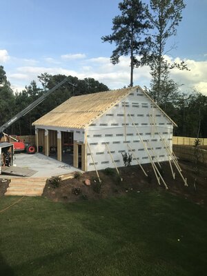

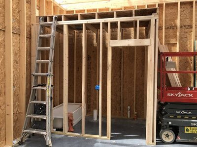

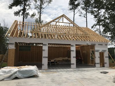

Thanks guys. Yes, it's stubbed and plumbed for a full bathroom in the back right corner. And there is a drain in the center in case I want to wash a vehicle or something in the winter time cold. There is also a upstairs room with stairs going up.

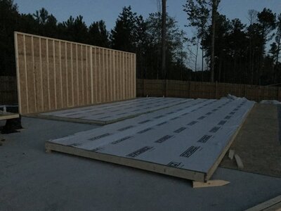

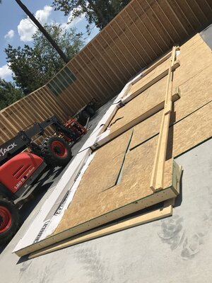

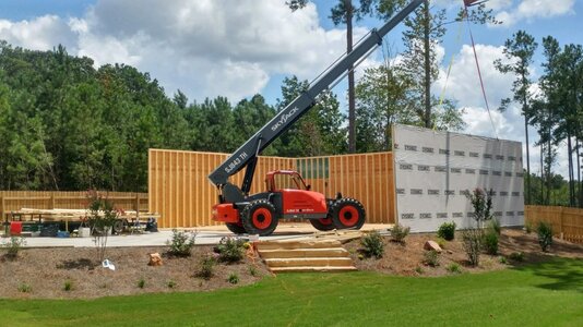

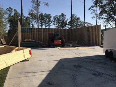

Got home and the back wall was built, and the right hand wall is built ready to stand tomorrow. My buddy owns the construction company, we grew up racing Dirtbikes together. He isn't subbing everything out like most and is doing it with his crew. So everything is being done like I know it should be.

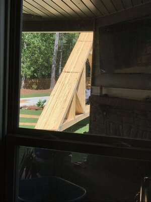

That is cheating!
2 guys, 3 2x4x12's and stand that joker up by hand, the 2x's are attached up top, as you lift they became arms sticking out so if you need to stop they will help hold up the wall until you get lifted up all the way!!!!!!!!!!!!!!!!!!
