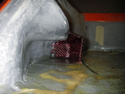

Sure. I'm not sure where I'm going with them yet. I was going to use the carbon/kevlar on my dash but it would have turned out ugly so I had to use it for something... My glasswork was pretty bad in this area so I figured this would be easier than trying to turf. Plus I didn't really want turf on the inside wall. Anyways, here are the pix.
wf, when you remove the tape won't it screw up the cut?

That's what I used around my footwells in my previous pics. They were supposed to be orange/black but it was more of a red :dunno:. I couldn't keep a straight line at the time but maybe if I tried the tape method...
