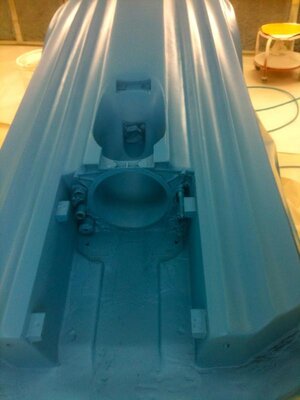

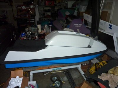

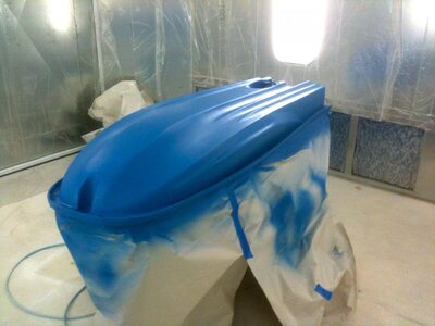

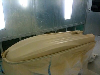

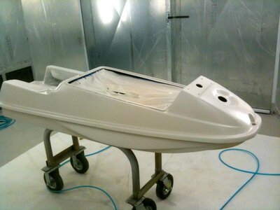

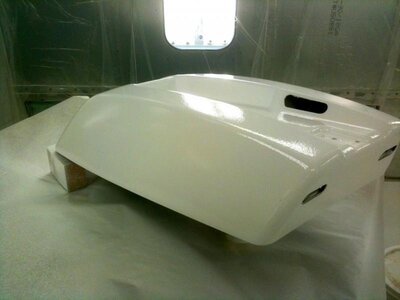

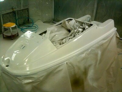

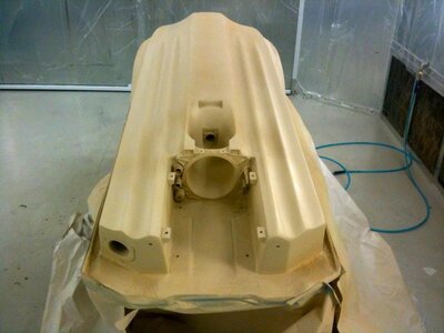

Some paint prep and primer shots. Had some learning curve with the paint and gun. A few drip areas where the clear got too heavy but nothing some graphics won't cover up in the future. Was planning on going all white, but when I ran out of paint I thought I might as well give the bottom a little color since I was buying another quart. Turf and re-assembly next.

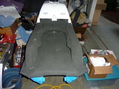

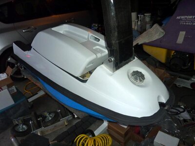

Started on the turf. Made the mistake of using welwood green can contact cement on the pancake Pete and the left gunwale. It was not sticking down well at all unless I heated the glue up to become tacky. I finally ripped those pieces off after reading to use the red can. Thankfully I bought a large sheet of turf. I just have the rails to do still.

getting closer

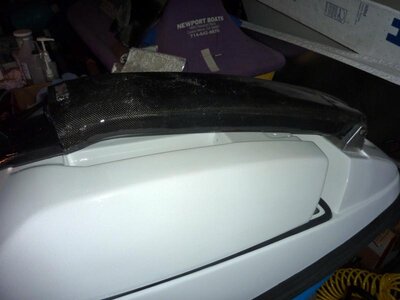

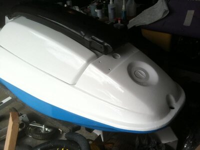

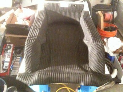

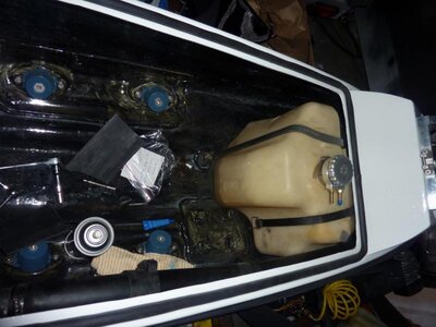

a couple of progress updates. Turfed rails and installed SJ gas tank. Installed stator, bendix and flywheel. It's starting to come together. Waiting for motor shims and need to make an ebox gasket.
