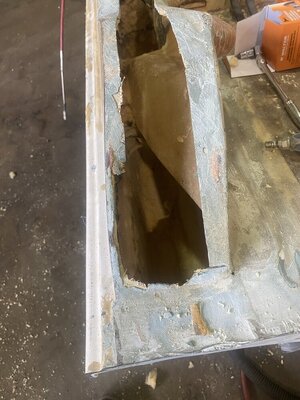

Lady’s and gentleman… the long wait is over. The project is back on the agenda. It’s only been 5 years since I started this thing but 2 wife’s and 1 kid later and we are back on track. I decided to defoam the tray and try the pingpong ball method. So far, we are at 100 balls. A9DC2D01-B94C-46F2-B136-DA1FCC4F23AF.jpeg176A0363-4B78-4F6B-ADE1-132B5B85EBA0.jpeg

Did some quick and poopty glass work. Going to grind it down and redo it next week hopefully. Had to order more pingpong balls. For anyone wanting to do this, I’m at 300 balls. Ill let you know how many it will take to fill it

Looking good! But I dont think ping pong balls work. Joey from Hi speed did ping pong balls and his ski still sank to the bottom of the ocean. (has a build thread and sink thread on here somewhere) You might try and fill the gaps between the balls with 2part foam or EPS beads. https://www.x-h2o.com/threads/spex-lite-epp-beads-for-refoaming.207313/
I’m going to give it a try and if anything I’ll drill holes and fill it with foam. I’ve got a kid on the way and no time to wait for foam to come in lol
