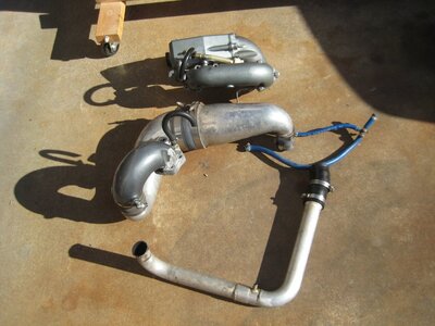

They said in that article the stock waterbox is hard to beat, and i hate how loud my muffler is. Would i be able to hook back my stock waterbox with this coffman exhaust pipe. If so, should i just move the water box over to that side? And water exiting the coffman exaust is able to go into the water box safely? Wonder if it can be positioned on its side
The stock water box will work you'll have to strap it down like a 650sx ie glass some hooks in fiqure out what bands will work get some of that matting rubber maybe you have a square to sit the water box on and may have to get special hoses from? Order them from somewhere as long as its a clear path and good turns if any
Maybe the hosing you have will work or be joined via a coupler?
Thats the way id doit , couple 3 layers of fiberglass cloth epoxy resin and hardner 2"x2" +- and some hooks of some sort.
And you'll probably have to get some bands from another ski or straps like yamaha
So hopefull. Thanks. Ya, im going to drop the waterbox back in. Ive got tubing and the stock waterbox padding. Just gotta mount it like your saying . I think moving the battery would be a good idea. And use those straps to mount waterbox.
Think you are going to have a tough time relocating the box to the other side of the hull. If you look at the outlets, it goes in the box on the front and out on the upper right edge, if looking at it from the tray. Way more work than its worth. You would be better off finding the coffmans that uses the stock box and trade or sell the one you have.
