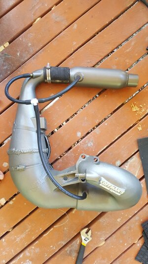

Hmmm. Could it be lack of water in the pipe? It seamed really hot. Uncomfortably hot , but i can hold my hand on the engine after testing a qUick tune test. how do i make sure its passing water when on lake. Garden hose i know works.

Drats. Im seeing some oil on the seam of a weld on the bottom of the pipe. I cant tell if its a leak yet or if it got splashed or dripped. From user error. Im guessing a small crack might also be the cause.

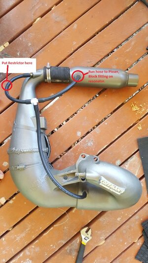

A crack will definitly cause issues and that pipe looks like its been welded before, but also that water routing is a major issue. Without a pisser all of the water is going into the exhaust. You want the exhaust as dry as possible without burning up the couplers, so a fine mist. I would unplug the hose going into the resonator and run that to the pisser, then put a restrictor, like a carb main jet, in the stinger so it only gets a small amount of water. Should be a whole different beast.
You just want to restrict the amount going into the stinger, but since its T'd and the rest is going overboard, water is still flowing and cooling the motor/pipe. You just want a fine mist going into the exhaust stream to lower temps so it doesnt burn up the rubber couplers. With the amount thats going into it now, is choking the motor out. And no prob, troubleshooting this stuff is my thing. I like working on mine almost as much as I do riding it.
I had know idea i could be flooding the exaust with water. I dont quite understand how putting water into the muffler/ end of the pipe will drown out the motor's performance. To my understanding all of that is done in the engine. But spraying too much water into the stinger causes it to drown out?
Ill be fixing that ASAP then. Can you please show me where I can get this restrictor? specifics would be great due to my lack of knowledge.

Alright. I dont have extra jets, or a threading kit. So ill just blowsion it. As long as that works. I think im nearing a resolution soon . Do some more welding, regulate the water at stinger, ill test the 95 low jet for kicks.
