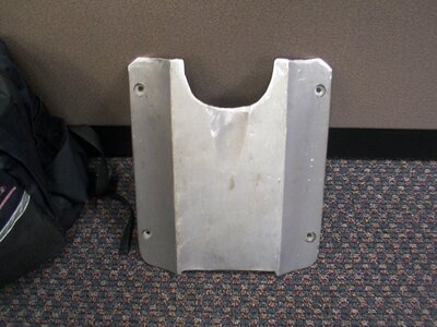

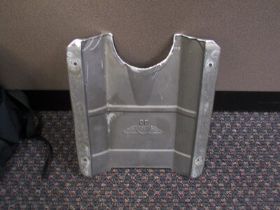

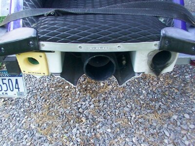

I D cut my jet dynamics plate, and it's made a real nice difference... it seams too keep some nice straight line tracking, carves decent in the waves, but breaks free much more predictably than the stock D cut plate I had before.
