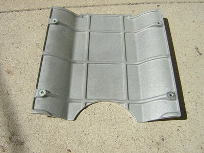

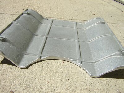

this is a stock sxr ride plate, cut flush with the back of the ski. 3inch radius offset out 1inch with .200" rad on the corners. i used a hass cnc mill.
made the sxr worthy in the surf.

I just went from a jet dynamics plate to a worx 305. I believe was the 305 a freestyle plate anyway, and man what a difference. Still getting adjusted to it. What does the d-cut do for the handling? SORRY! I just read the rest of the thread, I guess I will be doing this to my jet dynamics and let her rip!

I have a stupid question. I have a 1994 Blaster, and I want to cut the stock plate. Do you make a radius and leave 1/2" on both sides of that first lip of the flat part where you are cutting the D ?
1/2" on both sides closest to the rear edge of the plate? And do you put the adjusters back on, or is it OK to just use bolts with washers instead of the adjusters, and tighten it flat?
