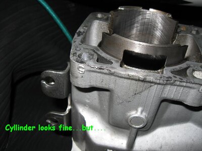

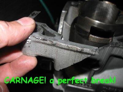

DJ, i have a 750 sx cylinders that I will send u if u cover shipping. Run a hone through and use new rings, you should be good. The sx cylinder can safely be run to 83.00mm and u can get half sizes with your big pin crank so u can get 2 top end out of the cylinder. I can get it out tomorrow or monday. pm me
Thanks bro...I am not a fan of the 750 porting...gonna stick with an SXR cylinder.. I really appreciate it!
