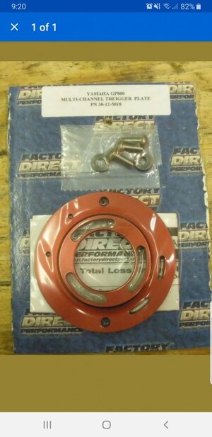

Is this the plate I need?
V-town
Sweet just got the plate. I Google searched it and there it was on Ebay for 50. So I bought it. Then asked if it was correct.
