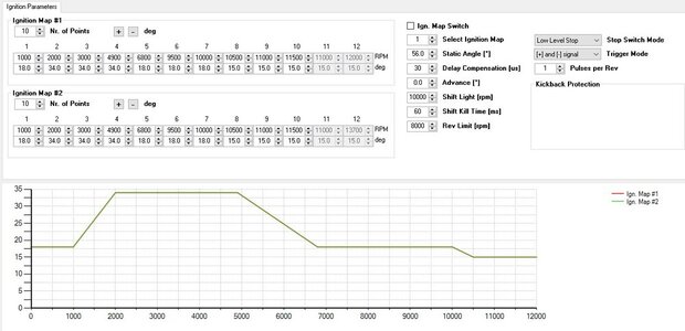

Some news for guys thinking about Total loss
Msd total loss help
Or make a new CDI/brain that uses all MSD components, just with modern features :) Stay tuned. Problem is that a 2 point trigger is unaccruate as fck, at 8000rpm a 2 point trigger can be up to 5 degrees of during fast acceleration
