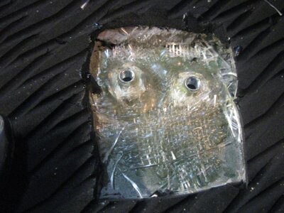

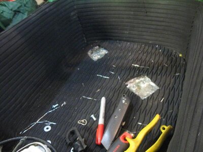

Adding a footstrap, but I didn't want to drill into my Trinity...it is still water tight! So I glassed in some nuts, (sorry Bobby that this beautiful ski has to see my shoddy glass work.) I just hope they hold and I'm happy. Turf will hide anything, right? :wave:
