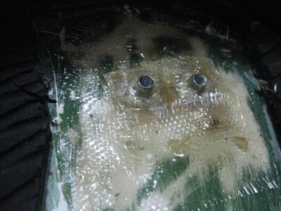

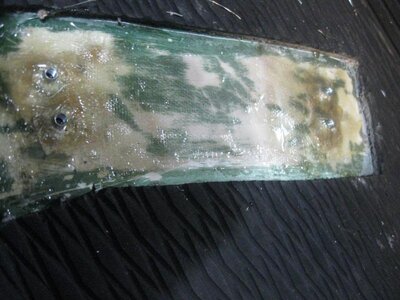

Should've warned you that polyester resin won't bond to epoxy resin (which i'm assuming is what your hull was made with).
Epic FAIL on the footstrap. Back to the drawing board. I guess I needed to scuff it up...hee hee. :crying: I am going to glass it down a foot around it. If that doesn't work, I'll fire stainless screws in with 5200 on them and then glass around them.
