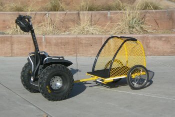

I like this idea better, pull a pin and it makes a sweet pit bike too. lol
One of these days I'm going to buy a Segway and pimp it out. This one has some pretty decent tires on it too. wonder how good it is in the sand?
