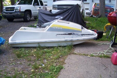

This is what I started with. A '90 or '91 hull (not really sure). Dig those graphics!!

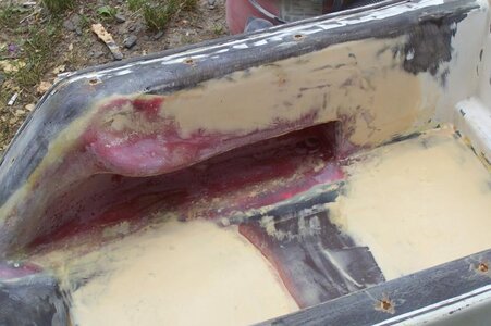

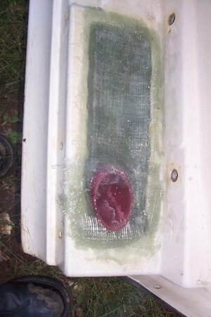

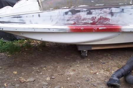

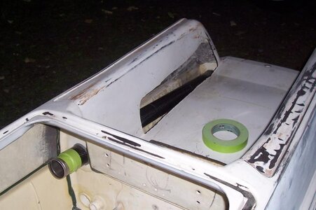

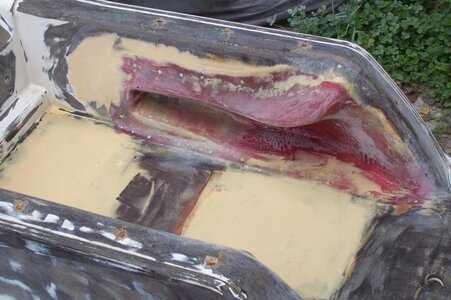

Cut apart for reinforcing hull, dual drains, footwells..

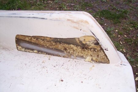

I dont remember why i cut it there. (Duh). Either to make it easier to add reinforcement or to make removing the exhaust easier....

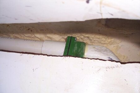

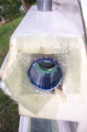

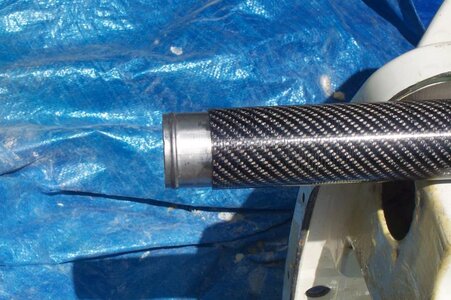

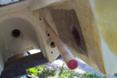

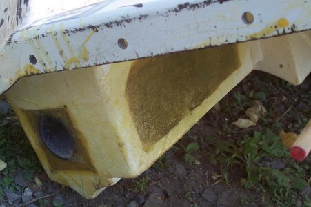

I wanted to lighten it up wherever possible. With all the extras it'll probably weigh about the same. I made up a carbon fiber exhaust pipe for it n saved a pound or two.

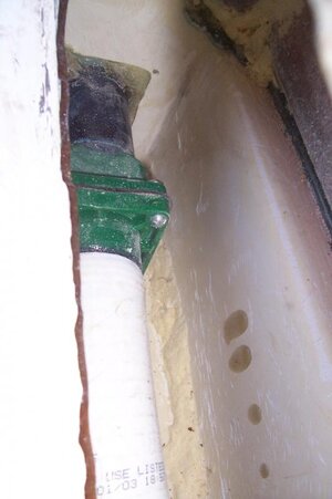

yeah, there's one way valves inside. If they ever start leaking, I'll put scuppers over them.

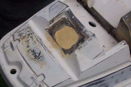

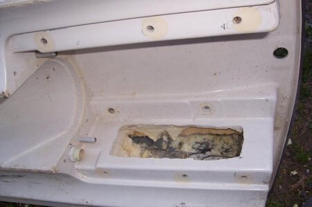

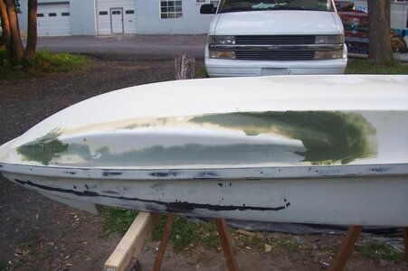

Also reinforced, refoamed and fixed a high spot in the deck...
